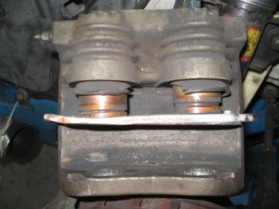

You don't really need to worry until things get a little worse than this (look closely at the piston on the left):
Caliper1
The boots had been burned up long before this happened.

If the car is mostly a street car or you drive it in winter a lot you can either replace them after track events or just keep a close eye on them.
Caliper1

Hmmm, piston on the left looks a little funny. So is it froze up and bent?
The trailing edge of the pad was down to the metal and melted the backing plate and the piston. Couldn't separate the backing plate from the piston, so I turned the whole thing in as a core like that. The other side was the same way.
The pads had about 1/2 material on them at the beginning of that session and I was trying to stay up with the guy that was beating me under braking. That's how I learned that R-4 pads aren't adequate for serious competition.
Some ventilation, either ducting or at least taking the fog lamps out, will help keep the caliper temps down and reduce the tendency to burn up the boots. I don't know of any way to prevent them from deteriorating on a track car that sees serious use, though.

My inside pads were slightly bent at the edge just like the ones in your pic. I am assuming that this is because of repeated hard braking and the high heat.
