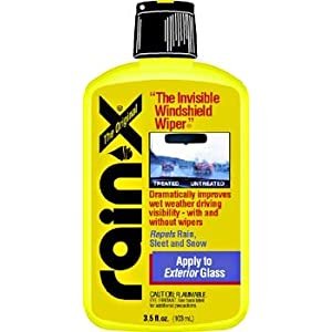

The fix is simple.
41N5WCBVAWL SL500 AA300
I used to live on the north coast of California. Rain central.
80+mph in the fog and drizzle was common.
The ONLY way to accomplish this with an old SHO is with Rain X ;)
