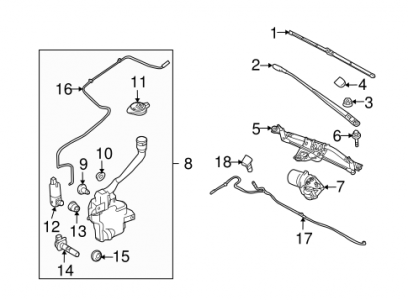

Very common problem. Those pumps just crap out.
Like a $30 part IIRC.
Takes 10, maybe 15 min of your time to R&R the part. So don't allow the stealership to schiester you.

Thank you everyone easy fix took about 10 minutes, i'm shocked damn pump only lasted 18 months all good though...... :)
