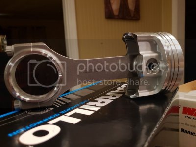

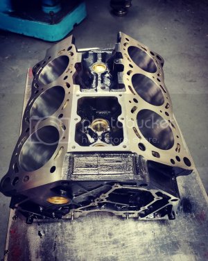

Did you beef up the bottom end? Weren't you in the low 10s with the stock bottom end?
10.1 @ 148 on stock rods with 13:1 CR wiseco pistons.
This motor is block filled, 3.3, wiseco 11:1 pistons, and CP Carillo H beam rods
How much Cost CP Carillo H beam rods? What is it part number on Carillo web?

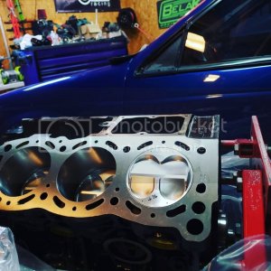

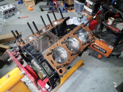

JUST A SMALL UPDATE ON THE CAR FOR PEOPLE WHO HAVE NO SOCIAL MEDIA.
20190111 215925 zpsrzg7wkfn
Thanks for the update, because I'm kinda one of those people. I'm working on it now though, LOL.
Well, hey, may I please ask who made those head gaskets for you? They look nice.
The rods are really nice as well. Were those one off set they made for you, or is there a part number for a SHO set?
Thanks.
zach44102
BIG TURBO
Jan 6, 2010
2,655
1,651
Georgia
The rods are built to order. And the head gaskets are from SCE Gaskets
The transmission is the HD gearset from Tony, and a quiafe diff. The transmission case has also been welded and braced
