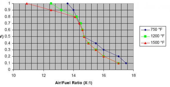

Yes, a narrow band will tell you if there is a lean condition, however, it will constantly tell you lean/rich over and over again. It will only stay lean if it is running pretty lean for an extended amount of time.
As for "peace of mind", how's this... With those bolt ons and being NA, you're not going to hurt anything unless you were trying.
Why would you spend $60 on a narrow band sensor? Your car already has two of them. Before you guy a TwEECer and WBO2, I really suggest learning the difference between the two sensors and how they work, as well as read up on tuning.

It's not so much the sensor as it is a gage that would be specifically calibrated to the narrow band which only puts out .0V to 1.0V. Any resistance in the circuit would throw the values way off too.
