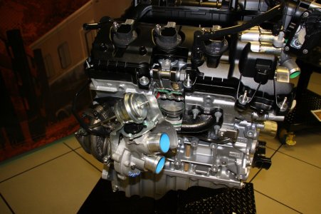

Thank you wchain I understand how it works now. But I looked at them online ford says they are honeywell/Garrett turbos. But from pictures those are no ware near any garrett turbos I know of. They look more on the like of BorgWarner turbos look at this:
100182858_2010-ford-taurus-sho-ecoboost-engine
100182857_2010-ford-taurus-sho-turbocharger-photo-by-rex-roy

What you have to remember is what you see on the manufacturer's website is a "generic" turbo. Something you would use if you wanted to add to a car that doesn't have one (ie: drag car, race applications, etc).
What's on our SHO is an application specific part that was most likely jointly developed by Ford and Garrett. It's probably the only application of its kind and heavily modified to Ford's specs. It will most likely look like nothing they have "off the shelf". It's real easy to design a 1-off when you get, say, a million unit contract.

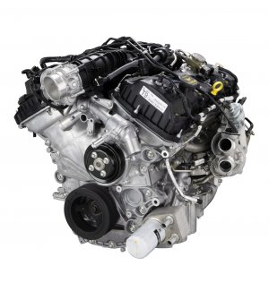

They are def Honeywell's. I've talked to the chief turbo engineer on the EcoBoost from Honeywell. Like itguy08 said, they are custom designed for Ford. If you want to see some close up high res pics of the turbos (including cut-aways), I have some on my Flickr account from an SAE event featuring the SHO I went to a while back: http://www.flickr.com/photos/24619344@N06/page4/.
If you think the FWD configured EcoBoost turbos look wierd, you should see the turbos on the EcoBoost F-150 (sorry for the super high res):
11f150 3 5l gtdimg
2011 f150 engines 10
In the end, it all comes down to packaging. In the F-150, those turbos almost hug the frame rails. So much so, that they had to put reliefs in the rail for them. They try to make them flow as much as possible, but it's still gotta fit in the car when you build it :thumb:

Good find Typhoon! Very interesting design to say the least. That timing cover looks weird with the coolant passages and t-stat housing right up front. Wonder how much of that engine shares parts/configuration with the SHOs?
