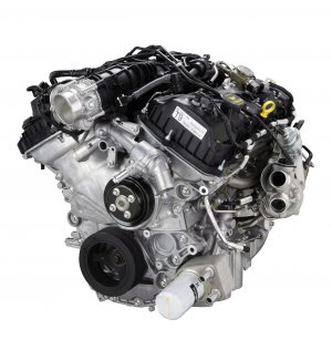

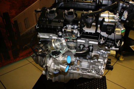

They are def Honeywell's. I've talked to the chief turbo engineer on the EcoBoost from Honeywell. Like itguy08 said, they are custom designed for Ford. If you want to see some close up high res pics of the turbos (including cut-aways), I have some on my Flickr account from an SAE event featuring the SHO I went to a while back: http://www.flickr.com/photos/24619344@N06/page4/.
If you think the FWD configured EcoBoost turbos look wierd, you should see the turbos on the EcoBoost F-150 (sorry for the super high res):
11f150 3 5l gtdimg
2011 f150 engines 10
In the end, it all comes down to packaging. In the F-150, those turbos almost hug the frame rails. So much so, that they had to put reliefs in the rail for them. They try to make them flow as much as possible, but it's still gotta fit in the car when you build it :thumb:
