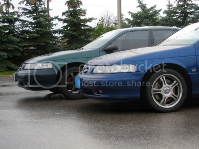

Kris (ddarkt) has wheels, not rims, very similiar to those on his blue '94. They look great on his car but then again his SHO is so freakin nice any wheels would look good on it :thumb:
Here ya go... http://www.shoforum.com/showthread.php?t=99263
Also... http://www.shoforum.com/showthread.php?t=99312 scroll down a bit
Thanks Jamie! Appreciate the kind word my friend. :thumb: I dunno about any wheels would look good on the car part though. Check out the pic below, American Racing Estrellas. :rofl:

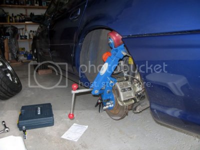

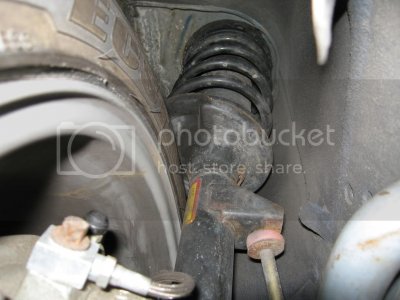

As for them fitting, they need to be around 38mm offset and fenders will likely need to be rolled. I have 245/40 on my car and I shredded a tire before I got the fenders rolled, there is also very little clearance between the tire and the strut too (around 2mm)...
IMG 0520
It's extremely tight back there. :oops:

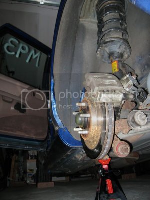

A Eastwood fender roller and a heat gun.

And with the fender rolled.

Look on your local Mustang forum, someone might have a roller available for rent. This was how I found mine.

Awesome fender tool. As the others have asked, did the heat gun help with not cracking the paint?

Thats the one we bought here in St Louis. Its a very nice tool. The heat gun is an art. you have to be careful not to heat the paint oo much, as it will bubble. Other than that, its pretty simple and works well.
