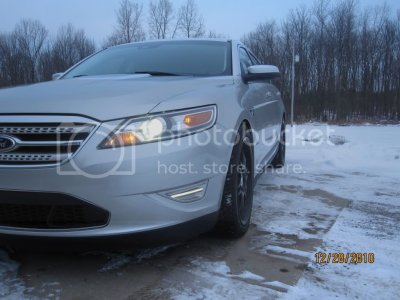

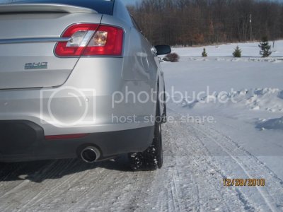

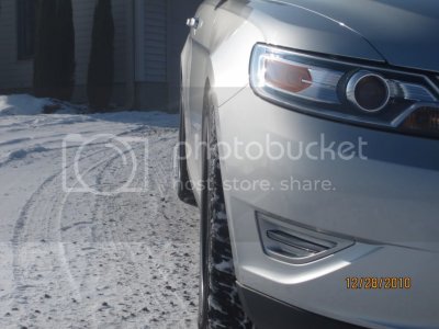

I use .500 wheel spacers in the front and .250 in the rear. 1 inch spacers in the front would cause the wheels to rub on the fenders. I have used 15 mm or .590" with no problems, but I would not go much more than that. The only thing with spacers you need to worry about is lug length.

first-sho are your wheels the same back spacing as a stock 20" wheel? also it seems to me that the back wheels stick in more than the front wheels on my car. the spacers i was looking at bolt on and then you bolt your wheel to that spacer(after a certain size anyways) so it just depends on what size i use. where did you get yours and what brand were they? do you recall about what they cost? thanks for the picks..
