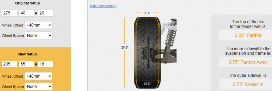

I'm using spacers on the Winter setup.

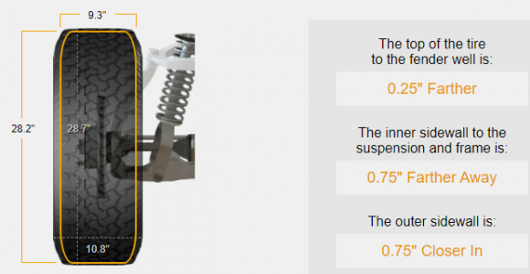

My Summer wheels are 20x9.5 ET40 and my Winter set is 18x8 ET40 so I'm ~20 mm shy of where the Summer set sits and I hate the rhino look of the SHO with the wheels "tucked" in.
I'd need ET20 but alloys with this ET are not that common which makes it hard to find a used set (for Winter) so I opted for the spacers. Yes, not the best option and I'm always a bit worried about using them due to all what has already being pointed out.

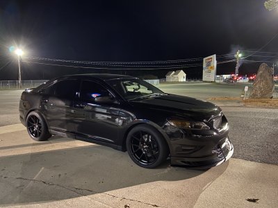

I’ve been running spacers for a while. It was always for a more aggressive stance. Never had any issues at the drag strip either with 1” hubcentric spacers with their own studs. Here I’m sitting on 20x9.5 Bravado Tribute+35 offset, 275/35/20 tires with 1” spacers all around8AB15BC3 E662 4A6D 8955 7F0A32A8A885

I’ve been running spacers for a while. It was always for a more aggressive stance. Never had any issues at the drag strip either with 1” hubcentric spacers with their own studs. Here I’m sitting on 20x9.5 Bravado Tribute+35 offset, 275/35/20 tires with 1” spacers all aroundView attachment 85542

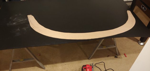

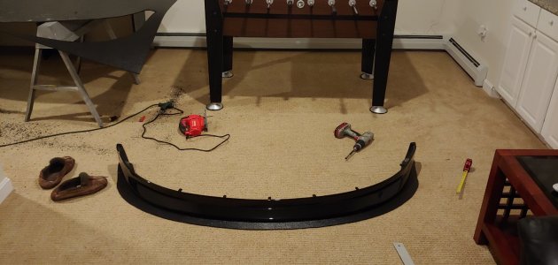

Where did you source the upper splitter that is screwed to the car's chin?

Thats cool, but, I'm asking about the UPPER/BLACK piece its screwed to.

Do you know, that this aftermarket piece originated from Mr. Rick Bottom, of RBDesigns, based out of Mendota, IL.?
It originally appeared on his 2009 "SHOx" which was featured in multiple, national based, car shows in 2010.
Rick had since sold off the molds to various aftermarket vendors and funny backstory, Rick was slow to respond to my inquiries, so I, using my own professional background, had a local agency reach out to him, compelling him in turn to respond to (my inquiries) about how to acquire his products.
Funny how things come full circle.
