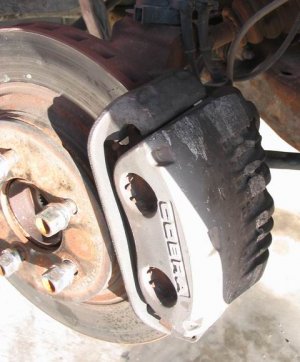

Bondobrake
Above is a 12" brake with PBR caliper. This is on a Bondurant SHO. You can see that there is a spacer so that the slicer wheel clears. On this one I think maybe somebody left the spacer off once since the caliper has been scraped up pretty good. This car got pranged in the front once, too, so it could be from that.

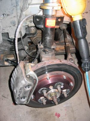

Baers
Above is the 12.5" Baer sport kit, which is on my silver track car. The two-piece rotors are from Todd Cook (tceperformance). The discoloration on the rotor hat (which I think is kinda pretty) is from heat.
So my 95 has had the stock brakes (which I did take to the track a few times), the 96 upgrade, and this 12.5" Baer kit. The 96 upgrade is stellar for the street and light track duty if you manage them well (I'm still impressed that Lance still uses them on the track). I went to the 12.5" kit since it has an aluminum caliper and is the biggest kit that fits under 16" rims. These are great brakes for the track, especially with cooling ducts.

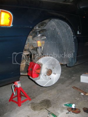

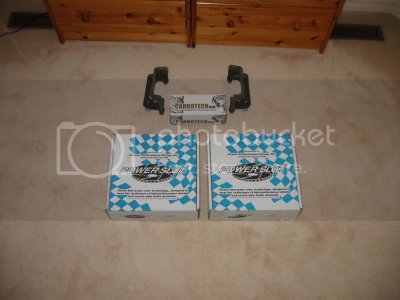

I have the 96 upgrade with Carbotech Bobcats and Powerslot rotors.
IMG 3231
IMG 3234
IMO it's perfectly fine for any street SHO. Much much better than what came on the gen IIs.

ant-live said:
What is the difference in the Cobra and regular PBR calibers? do they both require customizing in order to fit the 96 upgrade?
In the pix that I posted above the only difference in the calipers is that one says "Cobra" on it and one says "Baer" on it. They're both the HD PBR aluminum calipers. I'm pretty sure they're both the same piston diameters as well.
And yes, there is some customization to fit them on a 94-95 knuckle. They're not direct bolt-ons.
