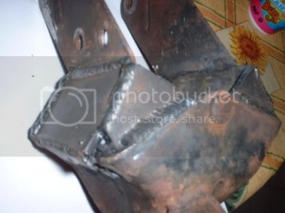

My front MTX motor mount was in the same condition. I boxed it and welded it solid :naughty: , so there is no movement at all now. It did cause some vibrations to transfer to the interior, but the car wasnt worth purchasing a new mount. $5 in steel, some wire/gas and a little time.
DSCF0026
Its not the prettiest thing, but it works.
DSCF0026
Pretty nice welds... You weld it?

SableSal,
Thanks, yes I welded it. I actually didnt worry too much about it looking good being that you cant see it. I could have gotten away with a single pass which would have looked better, but I just figured Id have some fun with it and go a little overboard. Once I get to welding, I just cant stop, its like an addiction, LOL.

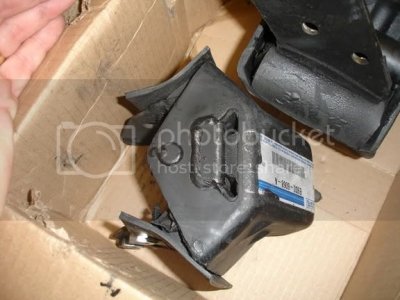

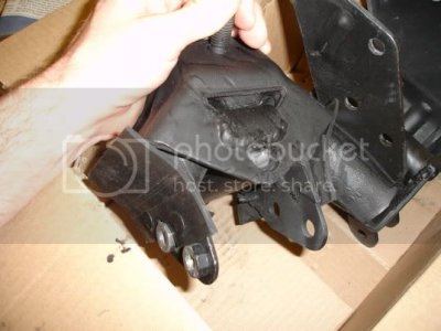

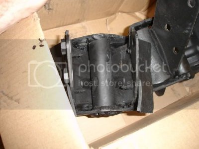

DSC01145
DSC01144
DSC01143
Question for you motor mount-smart people.
Are these Extreme motor mounts? I thought there would be less rubber to them. They look spraypainted, so I'm guessing they are the right ones. The ones in zuup_2000's pictures look like they re made of a lot more metal.
Josh, thanks a lot for getting these to me so fast. I would wait until tomorrow and call with these questions, (not that I doubt you) but a) I want to start installing them tonight, and b) you get a little advertising out of the pictures. :thumb:
Just so there is no confusion, the one in my pic is a solid mount that I made myself. Dont confuse them with the Extreme mounts you are refering to. Thats why it looks so much different. I was going to use the large bolts through the brackets method, like someone else on this forum did, but this ended up being easier. Plus, I had the pleasure of melting some metal :) .

So yours is all metal, with no rubber? And they aren't just regular ones, reinforced with a lot of metal?
Damn, you must feel every cylinder fire!
zuup_2000
Oct 13, 2005
53
georgia
CALL AAA said:
So yours is all metal, with no rubber? And they aren't just regular ones, reenforced with a lot of metal?
No rubber at all, solid as a rock. Yes it is a regular stock mount modified. It really isnt as bad as you would think, but it did transfer a little engine noise to the interior. I still have factory rubber subframe mounts, but if I had the aluminum mounts, Im sure it would be pretty noisy in the interior. The rubber mounts still isolate most of the engine noise, and vibrations.
