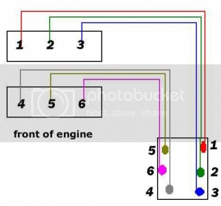

Anywho, after all that, the car was still misfiring. I sat and did diagnoses using my parts off my wife's car, to no avail. The wife has a 94 ATX, by the way. So now all those new parts are on my wife's car, and the 93 has parts I KNOW work (and the wife's car's running fine except an insufficient EGR flow code). The only code the 93's throwing is for O2 sensors, which makes no sense cuz they're brand new. Now, the car is currently sitting at a high school shop class letting them play with it. The best they can do is telling me that the #2 and #5 cylinders are misfiring. The shop teacher at first thought it was a coil pack.....but then we reminded him that the coil pack that was on the car when it was misfiring is currently doing duty efforlessly in my wife's 94. Everyone keeps saying the plugs are the culprit, but does that seem too coincidental that a shared set of cylinders are misfiring? That, and neither my modded 92 nor my wife's stock 94 have ANY problem at all using the same plugs and wires as is in the 93. I've heard of SHOs being finicky, but damn...c'mon!
So....can anyone offer any sage advice before I moltov cocktail this car into oblivion?

I checked that more times than I care to count (or could remember even if I did), and the school said they swapped the wires, too, just to make sure, with no effect.
