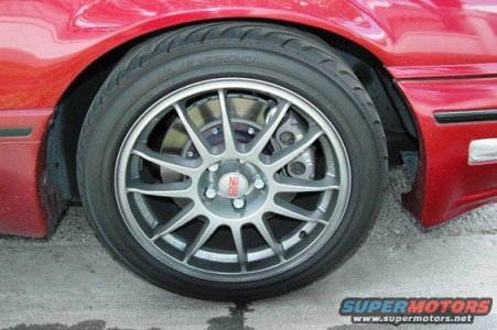

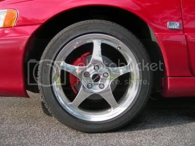

Right now with stock sagged springs my 225/50/17's rub, I need to roll the quarter edge, but do need tires soon, what would be the best with koni/eibach? I have Mille Miglia Actions 17x (8?) I'm not 100% on the width. If you guys have any close-up pics of what you're running that'd be great.

either a 225/45 or a 235/45. You might be able to get away with a 245/40 if the rim is an 8" the 235 will fit with minor issues even if it is a 7" rim width.

I have 235/45WR-17 Yokohama's on my 17X8 wheels. I had to cut and roll the rear fenders in order for the tires to clear. I plan on mounting 225/45-17 on my TD's which are 17X7.5

I would stay with 225/50R17. They fill up the wheel well the best and offer a better ride. I have 225/50R17 Pilot A/S's with Eibachs and I have very little fender gap.

the main reason for me not to go with 225/50-17 was the lack of summer only and competition tires. My SHO sits a little higher with 235/45-17 than it did with 225/50-16 with slicers that I had before.

I have the 235/45/17 yokohama avs sports for the summer and they fill the 17x7.5 with no problems in the stock size wheel wells with the tokico and eibachs.

Exactly. It's all about offsets on the wheels, and keep in mind EVERY 235/45-17 tire is NOT exactly the same width.
I have 17x8's on my Gen 1, with 245/45-17's, & Eibachs. The fronts, no problem. The rears, no problems if the car's empty & < 1/2 tank gas. The rears have been trimmed & lightly rolled, more is necessary. Did not rub at all on a Gen 2.
If 225's are rubbing, the wheel offsets are all wrong. Look at how much room you have between the tire & the strut tube.
