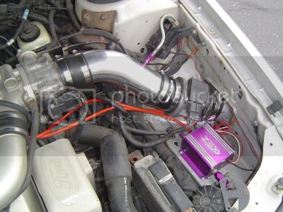

To the OP: Here is what I did on my own. As you can see this question always generates a bunch of friction on this forum. I'm trying to answer your question, and not get into the " I know more than you do" crap.
Hope this helps:
CopyofDSC05851
