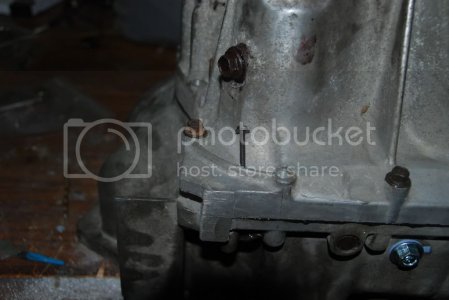

i have the trans together now and im hoping i just accidentally picked this bolt up, buuuut if it is from inside the trans its from the reverse gear/shaft area because i took that area apart a bit before i found the 'manual'
and on a side note why does the 'manual' say i will be soooooory for removing the detent plunger retaining bolt?
-just looked at this a bit more and i presume theres supposed to be some sort of bearing and spring assembly in there? looks like im going to be making something. :S

the remaining bolt, not very big :S

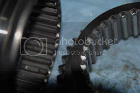

welded diff pins!!
DSC 2018
ground the burrs off/down, hopefully trans will be happy, no aluminium in my 'chicklets' hopefully my $200 tranny runs well
