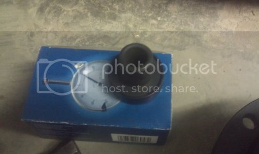

Timken SET37
Also agree with whats been said... chances are you will damage the bearing cup & cone removing it; besides your already in there might as well replace it.
Also, for installing the new cone onto the diff, their is a special ford tool used to press the cone on:
IMAG0161
Notice the lip; this allows the bearing to be fully seated, and the shaft part fits inside the diff helping to ensure the bearing is going on perfectly straight. Makes installation a lot easier... but if you can find a socket the right size that would also work.
Removing the old cups was a PITA for me... one came out easily with a punch, the other one I had to weld a bead along the inside in order to get it to shrink enough.
