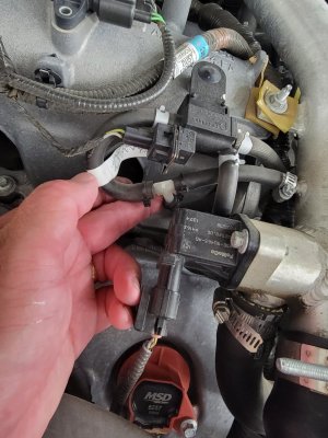

When I ran AEM I tapped mined as pictured with no issues. You can get the fittings and everything at any Autozone type place.

For clarification, the line isn’t connected anymore, I’m holding it showing we’re my T-fitting went.

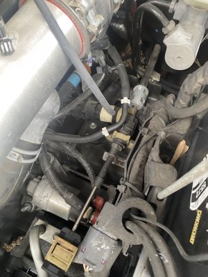

Easier to tee in here cuz the sizes are appropriate.
