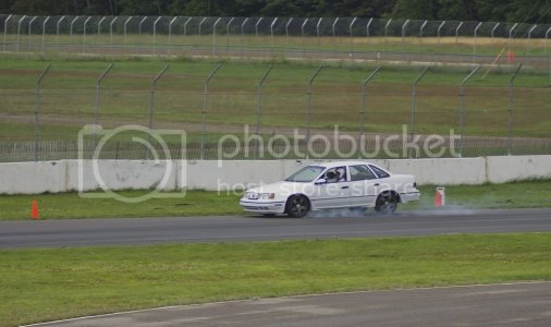

^^Yep!!
And I thank Chad AGAIN for being on the ball and catching that pic at that particular time!!
Anyway, note that the fronts are smoking more, and this is a non-ABS car Granted, the track was still damp, plus my brain fart........
Best SHO track pic EVER, IMNSHO!!

^^Yep!!
and you still made the turn too!
