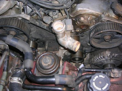

A KLDE and a Yamaha V-6 are two different engines entirely. This guy doesn't have a clue as to what he's about to get into.
This is the front of a KLDE. Rather simple to get to the timing belt, cam gears, etc. The cams are direct gear driven with hydraulic lifters.
Dscn3430
All the brackets and covers come off of the Yamaha just to get the timing belt. Then you have the rear cover, 3 cam seals, the cams, cam chains, tensioners, and finally you have access to the lifters.

Now go through and just look at what's involved. If this guy thinks can do put that amount of time in it for $250.00 he is by far in store for a rude awakening.
