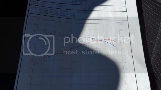

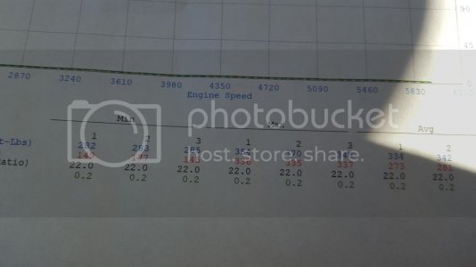

Here is my dyno graph and numbers from Friday. First run was V10 91, second V10 93 both using stock box. Third run was V10 93 with Airiad CAI. Run was on a Mustang AWD dyno which produces low numbers, any where from 7-12%, I added 9% to mine. The dyno operator came out and told me that the numbers where low, and not to freak out. I was looking for high 350's to 360's at the wheels and he said I got them.

Am I not understanding this right, but is the Airaid CAI showing with the lowest max? I find that ...interesting? I wonder how the Windstorm I'm about to install compares?

Wonder why the torque value is so different in the 93 tune?

So the V10 93 with stock box also has the smoothest curve, right? Just curious, did you have the pipe from the snorkel to air dam also installed during this dyno?

Manu, yeah it's my modded stock box, but not snorkeled liked the '12 was. Real surprise, is that sometime before the dyno runs, the tube I ran thru the hole in air box came out and not sure where it went????? Yes big difference between V8 to V9 or 10. The big torque different between stock box and Airaid is what has me shocked, but also each car is different. Been back and forth between V10 91 and V10 93.
