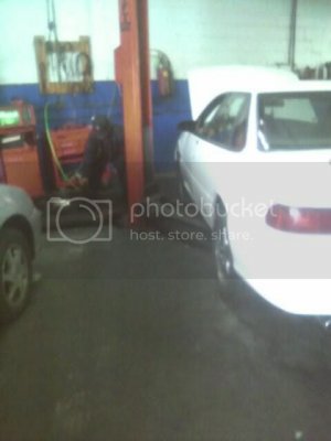

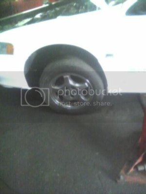

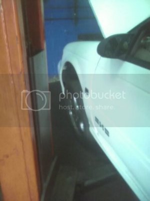

Just thought I'd drop in and give an update. The subframe came in yesterday after 6 hours of waiting, and the measurements came out to be perfect. So it seems, we'll have to drop the y-pipe in order to remove the subframe. . . . I snapped a couple of pics with my camera phone but none of the actual subframe. I'll take some of that when I get there shortly.
704472039 ORIG
You can see from this angle where the bottom of the tire is inward.
704472038 ORIG
704472032 ORIG
704472037 ORIG
704472035 ORIG
Not the best pics, but just an idea.

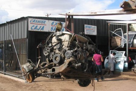

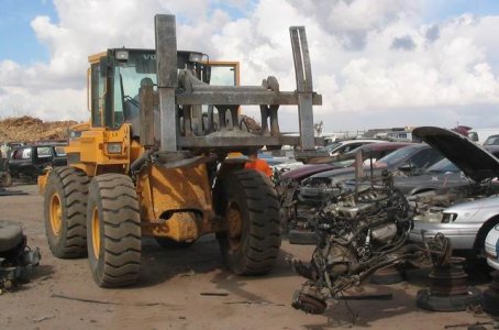

Where is the other end of that chain tied to? I hope not the intake, because it won't hold the weight of the engine and transmission.
And also, you don't really have to drop the Y-pipe; you can snake the subframe up and over. It's not the easiest thing in the world to do, but thats what I've done in the past.
Where are you getting the work done?
Shoaz
Studly dood
Mar 25, 2003
4,637
593
Scottsdale, AZ
Belt lift1
Belt lift2
That's a piece of seat belt tied through two runners and around the fork on the lift.
I don't recommend this at all, but in this case it held up the entire subframe and drivetrain assembly.
I'd definitely not use the tanks to hold anything up, if that's what you meant.

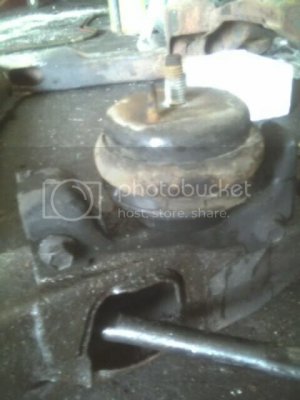

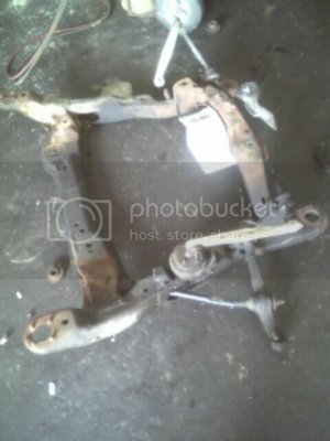

706057906 ORIG
Old SubFrame . . . . . . .

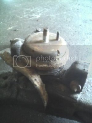

706057901 ORIG
Trans mount. . . . .
706057899 ORIG
Another view. . . . .
Honestly, I'm not exactly sure we he had the other end tied to. The work was done at a local shop down here in Brooklyn, Hamal. He had the old subframe out, and swapped in the new one in less then 1 hour and a half. It turns out the oil that I saw leaking from the subframe was infact coming from the tranmission mount which was damaged. The biggest pain of the job was inserting the strut rod into the lower control arm, and having the LCA line up properly into the spindle. Took us 30 mins to realize that I needed a new spindle and strut. So to recap. . . . .
