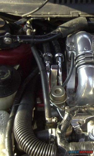

Here is the connection I made at the rack end. Prom steel line to hose, a compression fitting (it was a common size for 3/8" OD pipe I think. better measure the OD) to female NPT then a NPT to hose barb.
Ps splice compression connectorPs hose splice
I used 3/8" steel reinforced hydraulic line and good hose clamps. The other end at the pump I tapped the large banjo fitting for a NPT hose barb.
Small ps pump partsNew ps high pressure hose
It never leaked a drop nor suffered any steering issues. The steel reinforced hose will be ruined if you try and take it off so buy extra if you think you need to. Common at farm hardware stores.

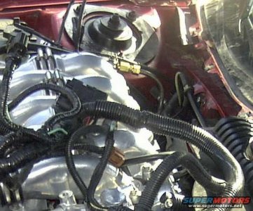

If its only leaking at the threads, which is common if only removed and reinstalled, you just need a new washer. They are Teflon, which makes them just a bit more tricky to apply. I usually soak them for a few minutes in Mercon-V to soften them up, then use a socket that is just as large as the threads to stretch the washer on. If you push the washer over the threads directly it can get damaged and leak.
Edelmann 70005 POWER STEERING... https://www.amazon.com/dp/B000OQOPHE?ref=ppx_pop_mob_ap_share
Otherwise SHOZ123's solution should work good.
