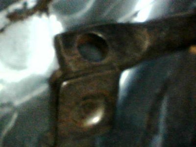

BD460B4C ACBD 46FC B556 5F82CF83884A My car has had an underboost code on it I cleared it goes away ( obviously ) then comes back. This is my first SHO car feels powerful to me I happy as a pig in the S#%T. Took it to the dealer was gonna have diagnostics done to see what the issue was lead guy takes a ride with me an says I would feel a great difference in power with a underboost problem , got no engine light on either. He said it could have been an old code some get stored and stay there. So I take his word and drive on. Now I am happily tuned by AJPTURBO load the tune in and I’m like wow this is great. So I do a little data logging that Brad wanted me to do AAND ! He says I have a big underboost problem not seeing any of the power he is commanding. So I start searching for hoses off things of the norm we should look for. Hoses ripped torn ect... found one thing are these big enough to cause my underboost issues. It’s the charge pipe that runs along top of engine plastic - rubber -plastic and right and the next rubber section I found these. That hose must expand and they gotta open up a lil No ? Lmk

It’s those two little tears between the plastic and the letters aem that I found are those big enough to lose power ?

If they are actual tears through and through, yes. These pipes flex under boost, so what seems trivial at rest can become a gaping hole under boost. I would think you would be able to hear the escaping pressure but probably not with the hood closed or the cover on. Tape it up with duct tape and see what happens.

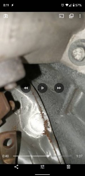

So I have this exact same problem at the moment. The wastegate actuator isn't connected to anything on the front turbo. I have a picture of it but can't really get to it from above. I can feel it with my hands but that doesn't do me much good. Anyone know the best way to get to the clip? Hopefully I don't have to pull the turbo off. 80d11cf899f2b778c82e5b19aef301061d0ae26d74341726fd6457abe0dd01a6

We got mine hooked up from underneath. U will have to take the covers off , one in the front you can get your hands in there. However I did not do myself so can’t really explain what it looks like under there but was done in minutes so u should be good to go. How long has it been disconnected do you know ?

It's been around three weeks. The loss of power was noticeable and I scan the car a lot. I've been troubleshooting it since it happened a little at a time.
