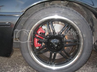

Here's a shot with the digi.. Maybe i'm a alignment freakazoid, but perhaps you can also see how positive the rear camber looks. Unusual look for a Taurus! :nut:

Take the shot again from the back of the car, looking down the long axis and frome about ground level.

More negative. What's the offset of the Tbird rims? I have the adjustment, it's just getting the wheels to clear the quarter panel lips. I wanted to set it around -1.25 in the rear. The furtherest i've gotten so far is -0.3 on both sides. these wheels have a 40mm offset and are 7" wide. The tires (GS-D3s) are a hair from the strut.
Here's the wheel shot...
Sho wheelshot
I'll take another shot of the car from the angle you mentioned Doug.

Going more negative should tuck the tires under the 1/4 instead of pushing them out. The Tbird's have a 42mm offset. Another question, what's your exact tire size? Sizes do vary among manufacturers, even with the same size. I think the biggest problem is you have chevy parts on your car!! :lol:
