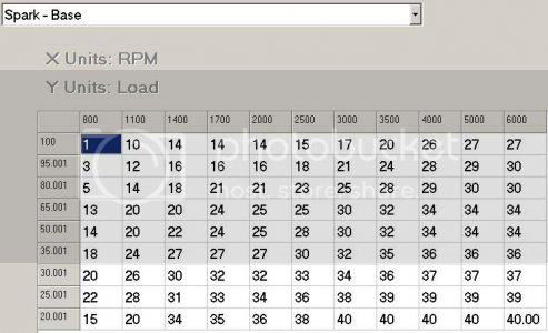

Lemme show you what my base spark table looks liek.
Disclaimer: This is from a CCF file that was taken off a D4U1 Ted B. LPM, so all the values are his, not mine. The only things I've changed past what he did are all the shift schedules/pressures, and global spark. How does this look?
Ted's modifications are an improvement, but they don't take into account all of the other timing tables, and consequently, the overall timing equation for the ATX computers. When modifying values in the base timing table for the D4U1, you also have consider the values in the borderline table, as well as the smaller multiplier and adder tables that are present in the listing.
Unlike the MTX calibrations, spark tuning on an ATX computer involves a bit more forethought and experimentation. ;)
