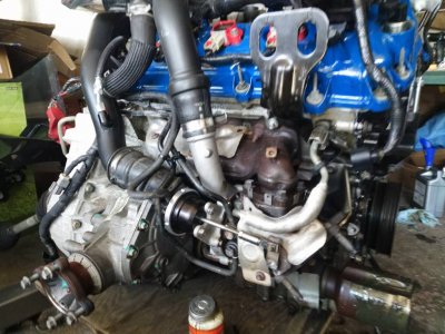

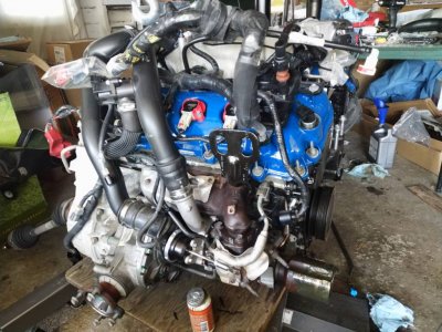

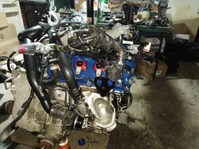

I haven't swapped them in the vehicle, but I do have some pictures with the engine out, that may help.
The front one is pretty straight forward after you remove the heat shield.
The rear, remove the strut tower brace, get the cac tubes out of the way, remove the engine lift eyelet. A hook pick and a 10mm flex head ratchet wrench will be your friend when removing the actuators. Carful not to lose the Wastegate hinge clip. Good luckAb647eed335a3dfb69b49fde2500d14103dd3a141e482092c0540b25f28633a02f6c402e95ba3b768a307d5417ac04a73671056c46f4252a4cfbc867f0979a7a
