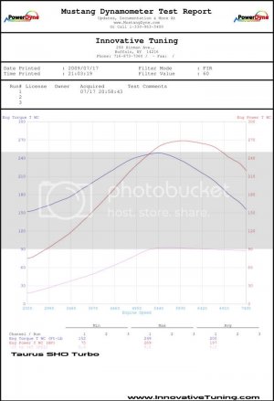

a bit disappointing if I'm honest. But the dyno don't lie as they say.
There was a dyno day setup at a local shop. So i though I would join in. everything was set up for rear wheel drive or AWD vehicles so my car did not get any fans to blow on the intercooler but honestly the tune is a mile off on this car right now, but I know the tune is safe so I will be attending the convention as the car sits. Nothing fancy I guess. I really expected quite a bit more power.

the fans should have been moved, we just all forgot
to be honest I didn't care all that much. the car isn't running that well + the amount of water that car sucked in today driving around in that down poor was insane. the car would probably run a high 13 or low 14 the way it sits now. that is a far cry from where it was a couple years ago.

It still goes like stink.. You scared the crap out of me on route 3 with black on black... haha.. I wish i could help ya some with the tune.

yeah, but it's an ATX, so assuming a 20% loss through the driveline (they dont' call them slushboxes for nothing), that's still 337CHP. Which is, to put it mildly, Not Bad. Even with a 15% loss it's still 318CHP...

This ATX SHO has no turbo and reads 372/366.
7,521
Plus, Mustang dynos are notoriously more conservative than many others, so if you tested it on another dyno you could find over 300 at the wheels....

I was going to say something about the fact that it was on a mustang dyno. Dynojets are really the only accurate dyno out there... every other kind leaves far too much to operater skill...

my car is running insanely rich as anyone from the convention that has driven behind me can back up. So once I get the updated tweecer files that josh is trying to get for me I will be able to take it somewhere and get a decent tune on it and turn the boost up a little bit more and have a fast car again. getting 18-19mpg on the highway sucks.

Me and Clay were almost crying on the way to the track Wed! That thing runs pig rich under 4K. Once the boost starts to come in though, it really leans out alot man.

Thats pretty rich, but I suppose pig rich is better then really lean no? SHOBOOM!

Looks about like my NA Dyno graph :cP Get the tune straightened out. I know your car has a lot more in it than that. :thumb:

the atx is 25% drivetrain lose.
thats on the low end for most atx's
i know of certain awd trans in the 22 - 25% lose range..
