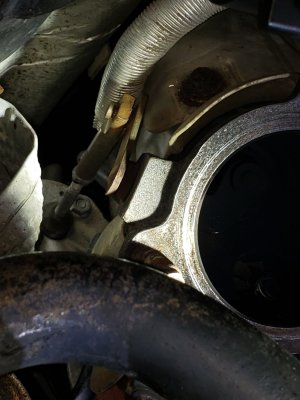

I was changing the oil in the ptu and noticed my rear turbo's c-clip was M.I.A. I couldn't find a post on its size doing a few searches.
I got a 5mm e-clip to fit. I dont know for sure if this is the corect size.
I bought stainless steel assortment from the deep Amazon's.
Hope everyone is doing ok.
-John

Usually i struggle to get mine off, here yours just falls off lol

I know this is an old thread, but I wanted to say thank you for posting. Mine has fallen off as well and the linkage actually disconnected causing some issues. I did not want to play guess and check.
