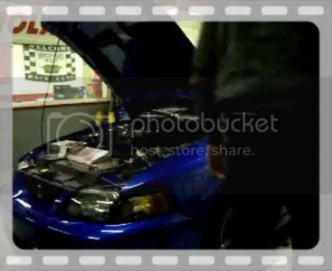

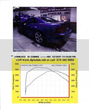

Right. This is a dyno graph from a car I just tuned. Ported Eaton blower with a +6psi lower pulley and a 2.80" upper with 60lb injectors. Made one **** of a noise. Had to fix the fuel system.
Th 100 0646
ScannedImage 5
This one needs more blower. It's outta breath by 4500rpm. Boost is falling as well as torque. But 500lb-ft of torque is a hoot how ever you slice it.

Well, if roots is so good, why didn't you put one on the SHO? :p
What the **** would you do with torque in a front wheel drive platform that is torque limited in the first place.
The more torque you make, the less you can use. Even in the Cobra, we had to run straps over the suspension to force the tires into the rollers. That much torque would spin the tires on the rollers (even a 248c).
