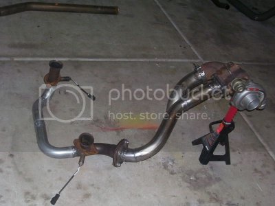

Heres my turbo. Note the thread diameter next to the tapped m8 x 1.25 holes.
This thread diameter/pitch is the same as my sending unit(approx 1/2" in center of taper). I'm only assuming the fractional designations for NPT is thread OD.
010
My oil supply hole seems about twice as big. I don't know, I guess I'll have to come over soon. I've already ordered the supply and drain lines(1/8/-4 supply and 1/2/-10). I'll call ya tomorrow;).

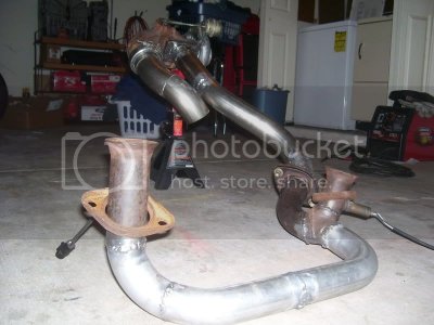

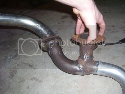

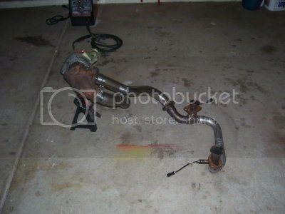

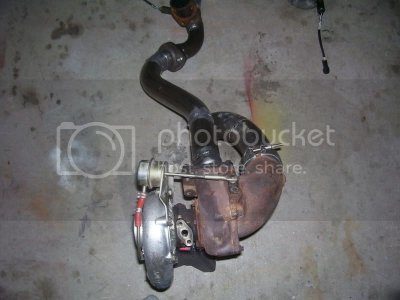

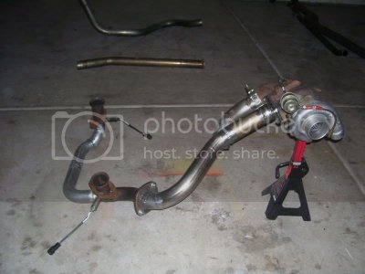

BTW, here are some more pics...
001 1
002 3
003 2
005 2
007 2
008 2
:thumb:
