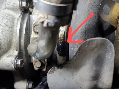

However if you think you can just blame the turbo without doing your homework first, then don’t bother the seller. There are a large number of possible causes of leaking turbos to eliminate before you would ever get to the turbo itself (PCV system, blow by, oil drains, oil feeds, oil level, oil pressure, catch-cans, etc.). While both of my cores were noticed to be leaking at 600 miles after install (smoking under boost), the Bank 2 core had a very dramatic event. It went from smoking under boost to full-time smoking including at idle just within a few days. It actually leaked oil outside of the turbine housing (see picture). The Bank 1 turbo leaked on the compressor side (visually confirmed) and left oil pooling within the charge pipes. There was no debate that the turbos were leaking oil, it was only a question of why.
