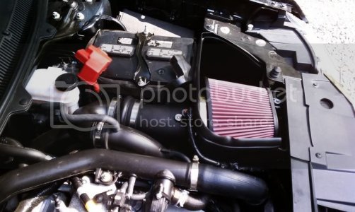

I can't help but wonder about that 180* turn in the air tube going to the front turbo, and the small size of the tubes. No experience with turbos before but is it crucial that the air tubes be the same length for balance? I can't imagine that would be the case since both turbos eventually feed air into the same throttle body. Even if one is running faster than the other, you're getting increased PSI mixed pre-TB so IMO, FWIW, those intake tubes can be tinkered with.
My first impression is to relocate the battery to the trunk.
IMAG0316
(not my photo)

I'm running the stock Ford air intake and have found that to be the best way for me to go. I did trim the outer hood molding in front of the intake scoop. I had a Typhoon and got rid of it. All those aftermarket "Cold" air intakes are a sham. They suck hot air from under the hood.
Well usually the top of the CAI box forms a seal with the hood that keeps engine heat away while allowing better breathing with a cone filter.
You won't see any improvement with a CAI on this car using the old pipe which has a bad 180* turn in it going down to the front turbo. The pipe going to the rear turbo isn't as bad but both are too small. It doesn't matter how big your filter is if the tube is only 2 1/2" after the splitter.
When you look at the Hennessy SHO that's the first thing you'll notice are two huge independent air tubes going to each turbo without a split. I'm sure that could be done for a **** of a lot less than $2,000 though. A company like JLT should step up.

FYI multiple guys have verified Airaid (and all of it's variants from LMS, Rousch etc) you lose .2 and around 2MPH in the 1/4 mile. I tested it back to back at the track as did others and we all had the same results. They sound cool but at the track they lose you power.
I did an Airaid UBI setup with their 3.5" tube - put the filter into the fender on my Flex and it sounded awesome, don't know if it made any more power.
I also recently tested on dyno taking pipe off the air box entirely and blowing outside air into it, no power increase (factory U bend and piping to turbos).
Guy on my forum is working on a carbon fiber intake with cold air setup and new pipes to turbos.
