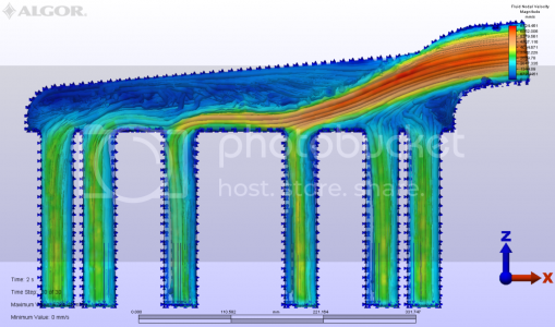

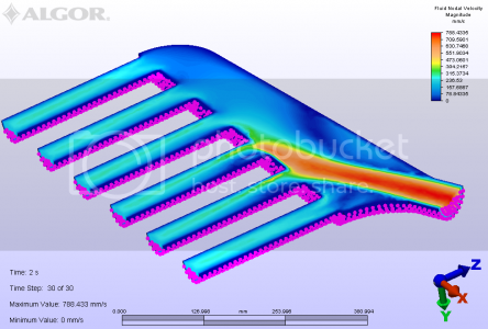

This may be hard to follow, but I will try my best.
The first example is our current intake design. What you should notice is that while not exact to our intake design it is very close. The entrance is very turbulent because lack of divider, but you get the idea. Cylinders 1 & 2 at the end of the plenum chambers are starving for air. What we would like to attempt is to have better pressure and filling at the end of the plenum.

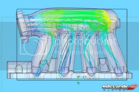

The next two pictures are examples of plenum chambers that are more state-of-art and very common today, many high end cars have these examples, and they provide better distributed air among the runners.
Intake2
There are some problems with the above plenum. While it seems to be a nice design the TB entrance could be better. The TB entrance should gracefully phase out to the Plenum walls, not just open up like they are. This causes turbulence and separation. Here is a comparison plenum below that offers better TB entrance to plenum. Also note how the entrance is not a straight shot across the runners. The slight angle helps keep the air along the outside of the plenum walls and equal distribution for the runners. Now take a look at the above plenum and notice how distribution is not ideal, its good but not ideal.
Skunk2IntakeManifold

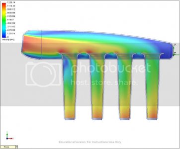

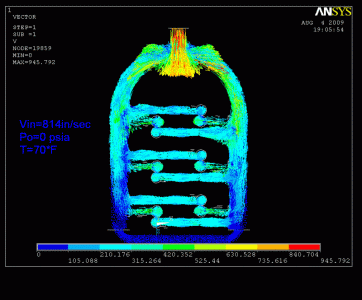

Don't believe me about the angle? Look at these examples...
Velocity streamlines 12 rev5 swirl
Notice how the bottom plenum has a good shape, but not ideal TB angle. Distribution is not equal.
Velocity contours
Thankfully the stock intake with its Y distribution helps keep the air along the outside plenum, but we suffer from max engine speed power. We just need to get more air into the plenum faster at high speed.
To be continued....
