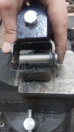

1) The Clevis pin I got from Jose a few months ago (apparently his last one) seems to be too short. It does not span the entire way across my shifter. Is this normal? It also does not fit through my shifter, diameter seems to be too big. I could really hammer it in there but if I do it will probably never come back out or destroy the Clevis pin in the process because it's just too tight.
You can see the gap here:
1025151849a zps23tgwvmx

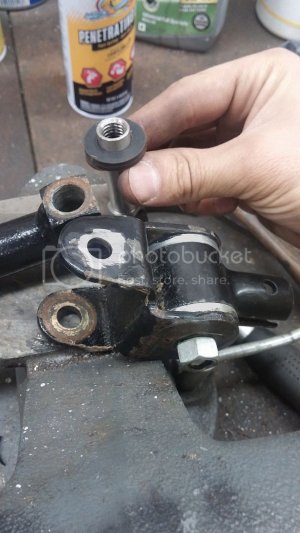

Pic of the bushing I'm talking about here (not the pin in my hand):
1025151833 zpssqyxmlla

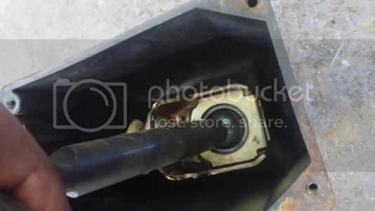

3) When putting the shift ball of my SHOrt shifter in the shift box, there's quite a bit of play. My stock ball fits very snug with no movement at all. Is this a byproduct of the Jose SHOrt shifter or is something wrong? I figure this isn't right because the idea of the Jose is to tighten everything up, not cause slop.
Pic here:
1025151635 zpsztaftij0

Just got a call from Jose. Looks like the shifter I got from Tim is worn out. The ball is supposed to be tight and I can see the wear on my shifter ball. The Clevis pin is also as I thought possibly a prototype which is causing my issue. Also my other bushing being aluminum is possibly my problem. Hoping he has one left in Delrin to solve my problem. Not sure what I'm going to do about the shifter though.

Thanks Tim I appreciate the offer. Did you have any play in this one when you pulled it? It's pretty bad. It's not even a hair and I'm being **** about it, it's actually pretty worn out. Kind of weird actually because the boot is rubber or a hard plastic so I don't see how the shift ball could actually wear out this bad.
