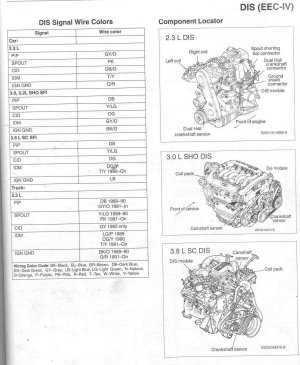

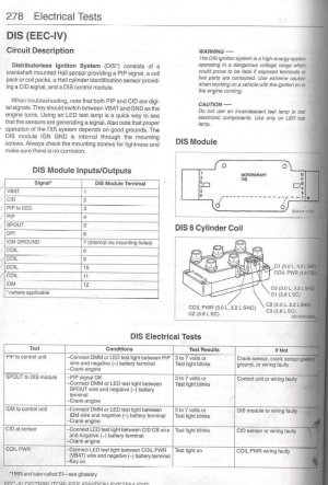

The cracked connector can be very old plastic but, it is also common that there is engine movement from a worn out engine mount. The DIS wiring harness has a little slack but not enough if there is extra movement. The mounts allow for a tiny amount of movement but they degrade and wear over time.
