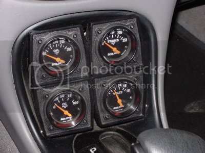

OK, this is the photobucket location for the photo of the 4 gauge panel that I just uploaded:
http://photobucket.com/albums/y136/newberg/?sc=1
I am still willing to upload it directly here, if someone wants to remind me how to do so.
pax, smn
PS: I just tried that, and it works, but it also has the photos of my Star that I posted up there some time ago, so you get to see it too. :)
MVC 014S ;)
Are they all electric gauges?

Ah ha, that is how you do it. Thank you David. Of course, the trick now is to remember it for a couple of years for when the next time I get asked to post a photo comes along.
To your question, yes, the are all electric Autometer gauges. When I first put it in, I had two Autometer and two Borg Warner, but I ended up needing one of the Borg Warner's for something else, and it would have looked funny to have only one, with three of the other, so I just went to all Autometer. Very good gauges, by the way.
