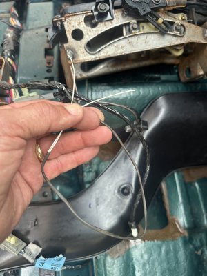

Is this thread still followed? I have a problem with my shifter not coming out of park. I pulled the console out and found 2 broken thin gauge wires but I can’t see where the came from. But it shifted fine until I took the console out.
zoomlater
May 31, 2004
3,691
1,911
Seattle, WA
I think those are used for the overdrive button on the side of the shifter, my button stopped working awhile ago
