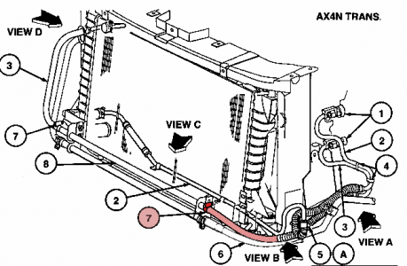

The place to take fluid is the return line back to the transmission from the cooler. Out of the radiator cooler, follow one line to the aux cooler input, follow the other line out of the cooler, and disconnect this line. One might remove, agitate, and dump the cooler as one of the first steps, but that's asking for problems as much as it is solving them.
Disconnect this line highlighted in red, at the cooler if you have no other disconnection points in the line other than at the transmission (needing a disconnect tool). You can put a drain hose on the cooler outlet into a bucket if not your machine, that way you can see when it starts to sputter air:

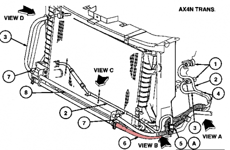

WRONG LINE !
That is the power steering line.
Take off the TOP hose, #7.
Yes, oops, callout #6 is the power steering fluid line. #7 "clamp" is not helpful, but that's your spot above #6. Fixed the picture.
Hard to track the lines out of the transmission from this picture.
