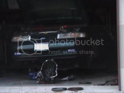

you can kinda make out the subframe in the backround.
