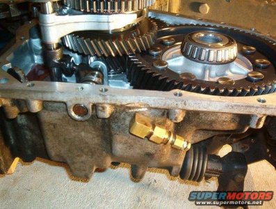

60k maybe? shrug The plug is also very useful for draining the trans for removal or for trying different fluids. It's also nice to be able to drain your redline fluid back into the bottle after it's been in there for 50 miles and you have to pull the tranny, rather than wasting it. Here is a pic of mine. I used an elbow instead of a plug so I could install a temp sender and so I didn't strip out the threads in the case. (Which I don't believe is a problem, it just would be for me knowing my luck.) Getfilephpid108046togglefullsizefIM000345
