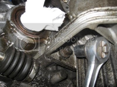

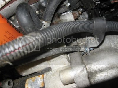

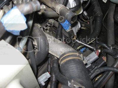

Hi all,
Well, I've put a newa clutch on, welded the diff and replaced my synchros and blocking rings. Now it is time to put it all back together. My question is, when bolting the tranny back up, which holes take the studs and which ones take the bolts?
By looking at a couple of diagrams it appears that the 2 top ones are studs and the one by the starter. The rest are bolts. Is this correct. I guess if someone could just give me the order. If I have the tranny slid into place and am looking at it from the drivers side...starting at 12 o'clock and moving clockwise. Thanks for all the help...next time I will have to be more descriptive with the bolts when I take them out. Right now they are in a baggie that says "bolts for trans to engine"

Hope these pictures help. Stud at starter for ground cable. One stud on top holds front of the wiring protection plate that is mounted atop the transmission. Small 13 mm bolts go through oil pan front and rear. Rest are 15mm.

Thanks, the pics help alot. HOpefully I will have her back on the road this week some time.:thumb:
