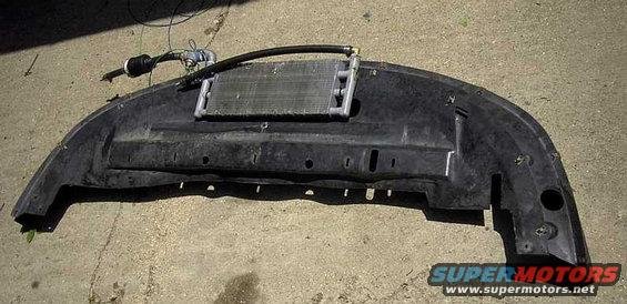

Disconnect the OEM cooler on the drives side.
Hang you cooler they way you feel is best. I have hung mine with zip ties from the bumper support with no problems but currently lay it horizontal over the bottom gill slits on the black splash shield.
Connect the new cooler's lower connector to the line you disconnected and the upper connector connect with a hose back to the OEM cooler.
This is also the place you want to disconnect when you flush. You can get a Magnafine in-line filter to use as a union for the two hoses.
Id106354togglefullsizefNew cooler and filter
6356togglefullsizefBottom of horizontal cooler
