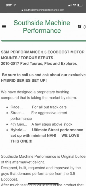

He is comparing the junk SSM mounts he bought. They market them like they are the best thing you can buy for the car. They clear up the NVH, but after awhile they developed the wheel hop again.

I didn’t make it clear in the video....
They are the hybrid mounts. De140ee96c5c00620864c6c404964a2d
I spoke directly with the owner, they told me the hybrid mounts offer the same level of performance as their race bushing but for the street. I specifically asked about wheel hop and was told that their new setup eliminated wheel hop while resolving the NVH issue.
I talked through the build I had and asked would these work as I didn’t want to throw money away? The owner said they had been tested on high HP cars and that all police units out his way were switching to them...
That’s my gripe.

I was really hoping they were a good solution, soft enough to deaden the NVH a bit but stiff enough to stop wheel hop...
Unfortunately they did not do what they were advertised to do.
That’s my gripe.
SBS, this is not a shot a you at all. Thank you for posting this info.
However, if the owner would have told me that, I would have said, "Thank you and have a great day." That comment is clearly complete B.S. How can your hybrid street mount, be just as good as your race mount? Why would you even offer a "race" mount then? It makes zero sense.

Thanks. That makes sense. They should list there bushing in order of stiffness. I would guess they are supposed to be somewhere between race and street from their description. If so, those do look very soft for a "hybrid".
