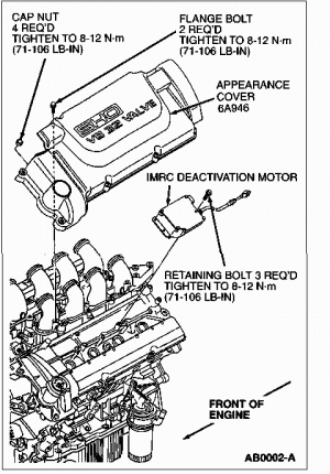

OK Kirk, did the first section and it seems to be a little better. Although, it still seems to do it just a little bit. Also something else I noticed after doing this was that at 80 MPH it does't seem to want to go into the highest gear and seems to tach a bit higher and hesitant to make the shift. It did that when I first got it and that went away after a while as well.
My next question is in reference to the IMRC plates.... What the **** is that!! :D :D I am not familiar with the abbreviation. Next, the intake cleaning, how do you do that and does it require a mechanic to do it?

Tunez:
Tunez,
If your car is dogging at those speeds, it's likely that the culprit is the secondary intake manifold runner control. If you remove the plastic appearance cover on the motor, there is a silver 5" x 5" box that sits on top of the spark plugs. Remove the screws for the cover and you'll see a cable that is actuated by a plastic pulley. These pulleys often break, leaving the secondary intake runner butterflies either open or closed. Seems like your car is starving for air at those speeds, so I'm guessing that it's closed.
http://v8sho.com/SHO/imrc.html
