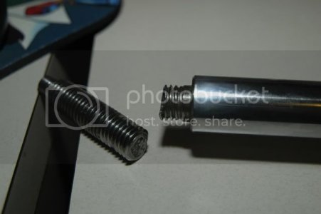

Well I had a little problem with my front Tokico Struts this week.
DSC 0072 640
From the photo, you can see that the top of the strut sheared off completely. Thankfully we were not on a high speed turn!!!

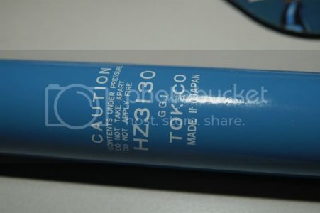

And these are the Tokico strut inserts.
DSC 0074 640
So I called a few places and was told that these particular inserts are now discontinued. I plan to send them back for a refund since the struts are lifetime warranty and I was told by Tokico that I have to deal with my original vendor for warranty issues. So they (SHOX.COM) plan to credit my account when I recieve a refund from Tokico.

The Tokico struts are shot... I mean that they sound like a rain stick when you turn them over. Something has come apart inside the insert. Also, I can easily press in the plunger with very little effort. I am going to just change them out and put in the Adjustable Koni's.
ShoBros. Thanks for the pictures. I plan to use the housings that I have on the car. These are that Tokico's that I have removed the inserts.

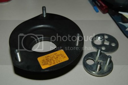

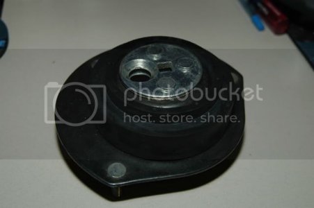

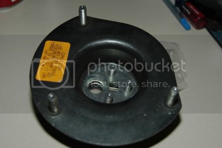

Parts are starting to arrive..
Today I received the Adjustable Camber/Caster plates.
Ingalls part 640
And a view from the top
Top 640
Bottom View
Bottom 1 640
All the parts
Parts 640
Hopefully I will receive the Adjustable Koni inserts tomorrow...

Storm-Chaser
Jan 26, 2005
2,786
258
Shit Louis
Those camber/caster front strut mounts look identical to the Moogs I got several months ago from RockAuto.
Outside of the orange tag (which is the same color), are there any identifying marks, serial numbers, or stampings anywhere on the Ingalls mounts?
