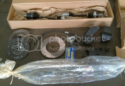

Put all these parts:
Parts

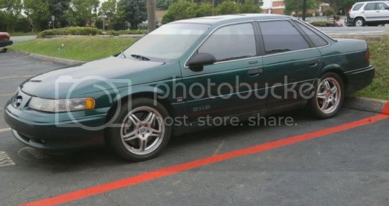

On this car:
Ashsho

Clutch, flywheel, TOB, BA looking axles, motor mounts, clutch cable , SHOrt shifter?
Sound about right? Haha, I have all the on my wish list. "
What clutch/PP are you going with? and What axles are those?
Either way, good luck!
-Josh
SHO source F&R reinforced motor mounts.
Brand new Trans mount.
Motorcraft Steering rack.
Clutch Cable
Stock replacement clutch.
Brand new (Not rebuilt) Axles.
The clutch is a stock SACHS replacement.
Needless to say, Ashley's car should drive pretty damned nice. :wave:

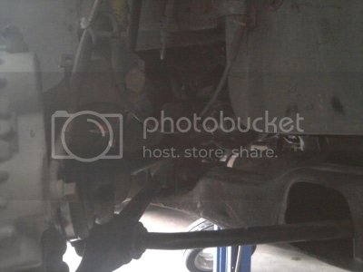

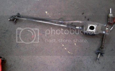

ok.. at the 5:30 mark, Motor mounts are in, Right axle is in, shifter is out.
Before
Axle
Found a ton of play in the joints near the trans. new shifter should make this car feel way better.
Shifter

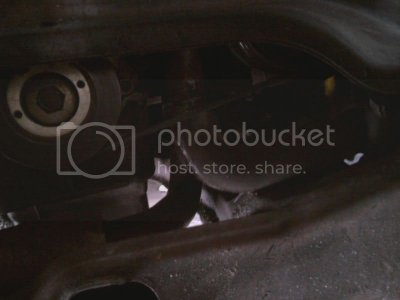

You forget the car is getting two brand new axles.
-Sam
I saw the new axles. You just can't pull the trans with the axle installed (in the trans). Since it is getting a new clutch the trans is coming out. I always just pop them out of the trans tie them up.
SHOspazz92
Banned
Jul 31, 2002
6,952
3,672
Triad Area, North Carolina.
I'm just interested to see how it is done with the axles.
FWIW, Every clutch job I've seen done has left the passenger half side in place and only the drivers side of the subframe is dropped, with the passenger side of the subframe just loosened up a tad. I remember when paul did mine, the passenger side wheel never even came off the car.
