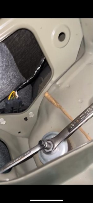

Tips for getting rear strut top nut off for coilover install?

If the above is not what you're asking and looking to rotate lower nut, get a correct sized ratcheting wrench like gear wrench or what ever brand you like 1690143326471
or I used to have a set of sockets that worked similarly called pass though ratchet sets 1690143614721. Socket set with ratchet that has an open middle to slide down long bolts to remove the securing nut.

I just did my rear recently. Did it with 3 wrenches. Small one up top stuck against the body so it dont move. The closed end on the nut and put a wrench to the wrench for leverage. Pretty easy. Once its loose you can put a ratshit rench to it.
Front shocks you need an offset rench. Mine didnt have a great angle so i picked up the cheap harbor freight set and they worked great
