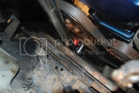

after trying jaming up my accessory belt with wrenches and only getting 70 lbs on the bolt i came up with an idea so brilliant i figured i would post it, i simply threaded a long stud into the one hole on the damper and then put my jack handle over it and wedged it against the frame, i got 120 lbs on the crank bolt, i just had to hold the assembly down while cranking on it.
