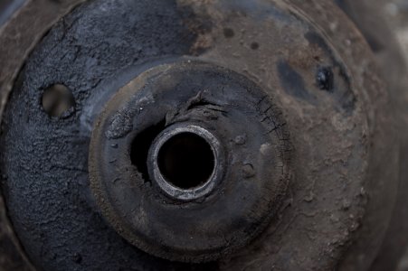

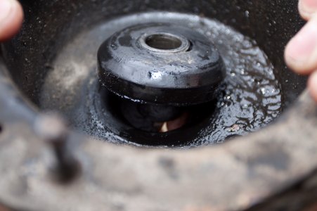

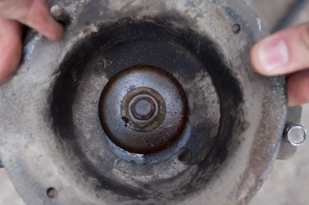

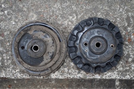

You can look at them, but I don't know what that'll tell you. I was able to pull mine out of the strut tower with them in the knuckle. Just disconnect the brake line and push the damn knuckle down as hard as you can and it'll come out.
here's what mine looked like but you'd never know it until taking off the retaining nut:
